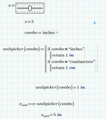

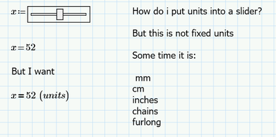

How do I put units into a slider?
Thank you
You can't directly put units on any advanced control...
...But what you will see on PTC's own worksheets would be something like
x: [slider] and then x2 or xunits: x*cm.
And then you use xunits for any further calculation or input.

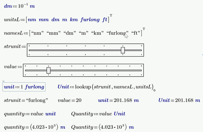

Not that I wish to be contrary, but after pondering this matter for a few milliseconds (or thereabouts) 🤔. an obvious (for values of "obvious") solution occurs to me ... 😈
I'm not a huge user of units, but this was a requirement that I've had on occasion.  Before Mathcad Prime 10, I went with a traditional lookup approach (see postscript).  Now that Mathcad Prime 10 is here, I slotted in an advanced control to choose the unit (as did you) before passing it to the lookup function.  However, a few minutes ago I spotted something in the advanced control Help that gave me an idea.  And voilà (or whatever French for "look there" is).
The clue is there in the image ...
Stuart

So you were kind enough to have the button "Show in Worksheet" pressed 😉
Clever idea and sure looks better than using 'lookup'. After all the vector unitsL isn't needed in your approach anyway.
I would rather use a listbox to choose the unit instead of using a slider (even if it would take up more vertical space or requires scrolling), but that may be just a matter of personal preference.
If the number of units to choose from is not too large, radio buttons may be an option as well. Unfortunately they can only be arranged in a column or in a row but not in matrix formation.
It may also be an option to define the value in front of the unit selector and use it as its second input

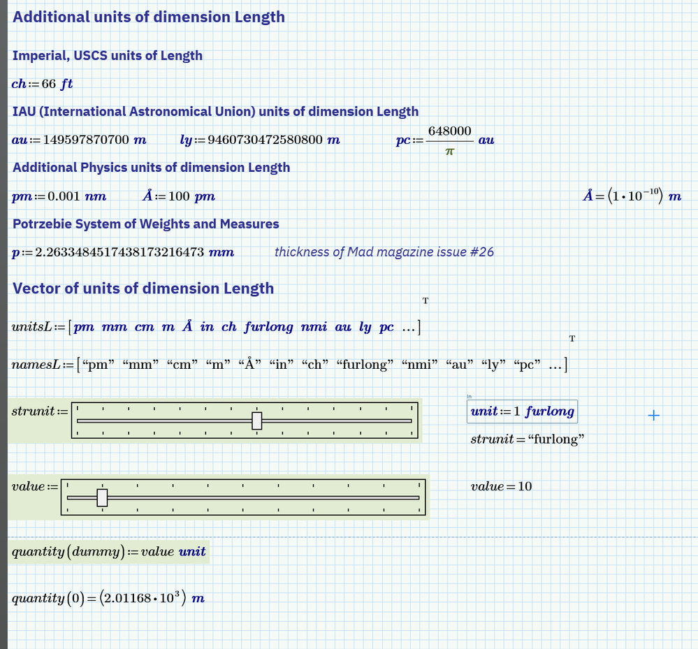

Sorry, @ppal .  I'd meant to post this earlier but was waiting to see if anybody else could think of alternate ways to implement adding units from an advanced control.
Here's the JScript code for the units slider and the worksheet is attached.  Hopefully, you'll still have to use it for your Frustum Challenge entry.
Stuart

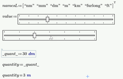

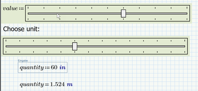

How about exchanging the order of value and unit input and using the value as additional input for the unit slider?
That way this slider could directly generate the necessary quantity variable and so we could omit the "unit" variable as well as the output variable "strunit" (because we directly can see the chosen unit in the assignment of "quantity".
For some fun you may change "quantity" in the script of the unit selector to "value" - Prime does not prevent doing so 🙂

Sure, it's entirely up to whoever wishes to use the capability how they arrange and name things.
As background, I'd started to write the worksheet as a couple of variants of a standard lookup table, but while looking for something completely different, my eye was caught by the following API Help.
https://support.ptc.com/help/mathcad/r10.0/en/?utm_source=mathcad/index.html#page/PTC_Mathcad_Help/API/example-8_vbscript.html#
5. In the worksheet, note the two input regions that define the input1 and matrixInput1 variables. Click OK to dismiss this window.
6. Windows Script Host notification window opens informing you the API uses the SetRealValue method to change Input1 from 45 kg to 12.2341 km. Click OK to dismiss this window.
7. The value of Input1 changes to 12.2341 km. A Windows Script Host notification window opens showing the number of output regions in the worksheet, and the alias for the first output. Click OK to dismiss this window.
A solution to the "units in slider" problem was immediately obvious and that was as far I wanted to take it, my brain cell having done its work for the week.
It also offers a route to solving another long-standing question -- how to import units from Excel/whatever.
Allowing an advanced control to be the body of a function will simplify things all round.
