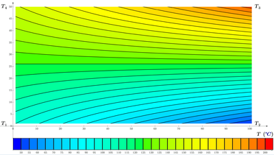

Can I have units in contour plot? I mean, i have stress function for example:
σ=σ(x,y)
x=[m]
y=[m]
σ=[MPa]
2 REPLIES 2
I use units (of Temperature) in a counterplot - see the picture and use the Mathcad Prime file in attach.

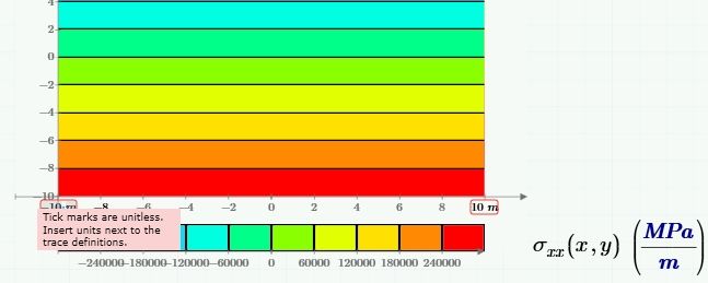

Like Valery was hinting at, there is no way to add units to the tick marks. So you have already included units in the best way possible for a contour chart.
In Valery's example, he creatively uses text boxes to create visible units on each axis!
