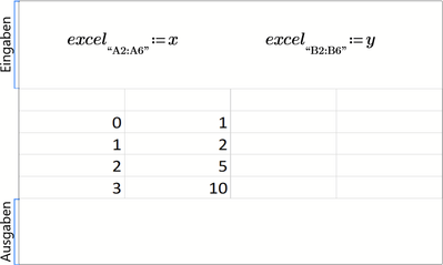

Why am I getting a zero in the Excel Component B1 cell?
gatlas
Team,
Note that I have been using Mathcad for decades. However, I've just started using Mathcad Prime.
Kindly see the attached worksheet.
(To:gatlas)
Chances are you once double clicked the excel component and somehow change A1 in Excel. Whenever you did this, the value will remain until you manually change it again.
I created the very same component from scratch in your sheet and did not experience the zero I also see in the component you created.
2 REPLIES 2
(To:gatlas)
gatlas
(To:Werner_E)
Thanks! I tried it again and it worked. I don't recall "double clicking."
