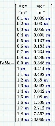

I want to import excel data to a table that has names and units... I'm adding the excel data and Mathcad file.
If you (in the EXCEL file) select and copy only the numbers, then paste them into Mathcad, Prime will create a table with the numbers but with un-declared variable names and units.  You can then fill in the names and unit values and the table columns will work like vectors in Mathcad.  An example is attached (Prime 8).  Your example (with multiple columns with the same names would be challenging, and using the same calculations with a different set of data would be an issue.

Yes, but is looks like the desired unit is mm, not m.
And as can be seen in the sheet I posted above, you have to make a compromise - either a text header or the preferred unit showing or a table without units at all 😞

Then you have to use a matrix without any text labels, just the numbers (and unit).
Prime refuses to multiply a string like "X" or "Kdata" with a number like 5.
Maybe you can come to the conclusion that you don't need a text header - the variable name of the vector can reflect its meaning and the unit is automatically  shown right next to it anyway.
Single vectors are more convenient to work with anyway as opposed to a larger table (matrix) where you have to select the columns for calcs using the column selector.
