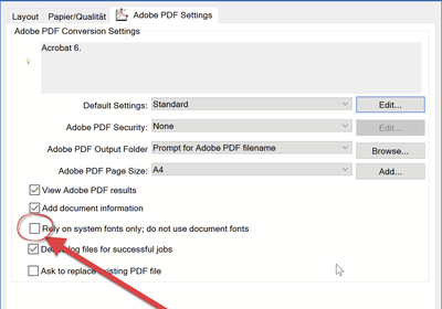

Try unchecking "Rely on system fonts only" in the settings of the AdobePDF printer
