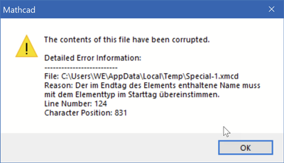

(To:StuartBruff)
I am not sure if Marcello was referring to the file YOU posted, because when I try MC refuses to open your file and I get an error message saying that the file is corrupted:
StuartBruff
(To:Werner_E)
Yes, that would be around the line I deleted.   I've quite forgotten how Mathcad 15 worksheets are encoded, so it's not surprising it can't read it (I suspected M15 might not read the file, but ...).
