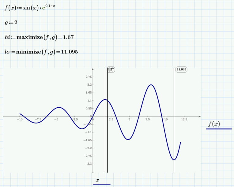

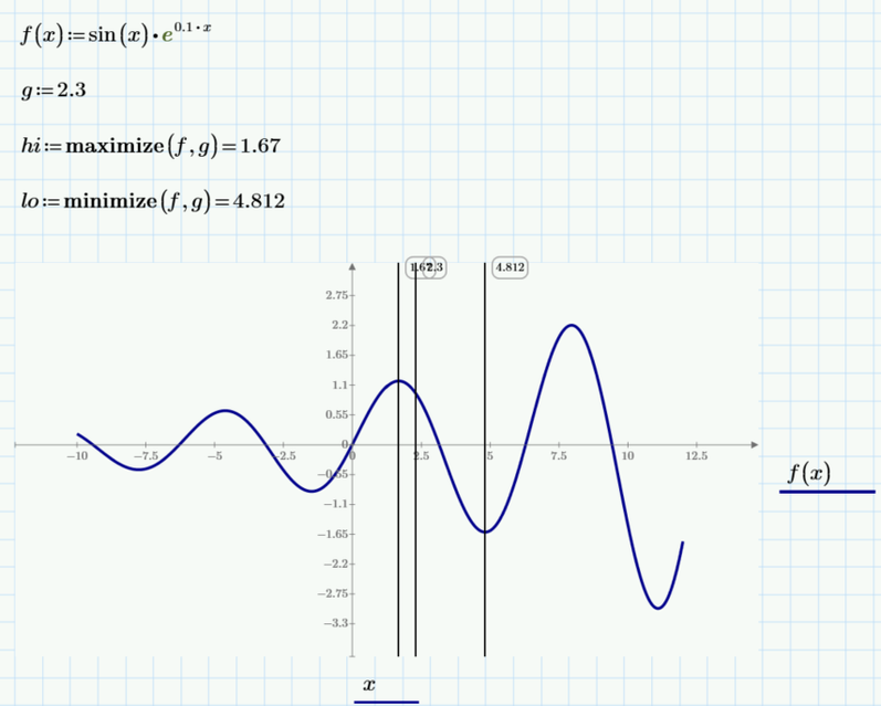

What could be the reason of which when setting g:=2 the first local minimum is taken as 11.095 (so jumps/skips over the first local minimum), but when using g:=2.3 the first local minimum is taken as 4.812, so the first minimum expected one value around 2.3 value. I would expected to see the first local minimum as 4.812 when using g:=2 as well.
My understanding is that by setting g:=some value, then maximize(f,g), and minimize(f,z) mathcad functions will take the first local maximum and the first local minimum around this g given value. Is not right my understanding?

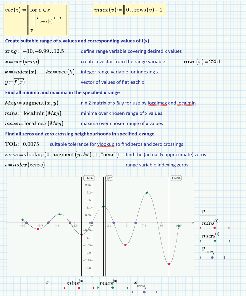

I'm going to take a wild guess that Tetsurō evaluated the function at a number of points and used a set of functions to return the zeros, minima and maxima of x & f(x)?
Something like this, perhaps ...
vec(z) flattens a matrix into a vector and converts a range variable to a vector.  index(v) returns a range variable that can be used as an index into vector v.
Note: I was just playing with vlookup - it's been a long time since I've used it - and wanted to keep it all to one page.  Look closely at the y[zeros values and you should see they either contain 0 or pairs of values either side of 0 (ie, the zero is probably somewhere between a pair of points).
If I was being slightly more serious, I'd have written a function to detect the zero crossings and make a choice as to which 'side' was nearer to zero and just choose that x,y pair.   However, zero detection within a vector needs some thought to take care of awkward situations (eg, multiple crossings in a small region, or apparent adjacency that only occurs because there are too few points to show the true behaviour), and my brain is too small to deal with that at the moment.   Of course, in this instance, it's easy enough to calculate the zeros within a given x range, but that's cheating.

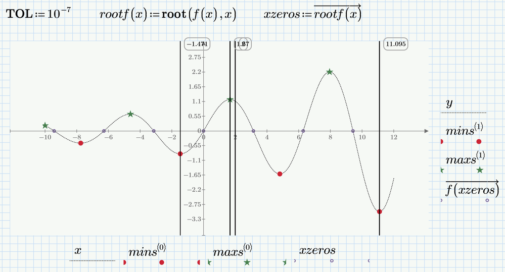

An alternate option for the zeros:
Advantage is higher precision
On the other side we get a very large vector with a lot of duplicate values and also values outside of the desired range
And because we rely on the algorithm used by the "root" function, we cannot be absolutely sure that with our selection of x-values (guesses) we can really catch ALL zeros within that range.

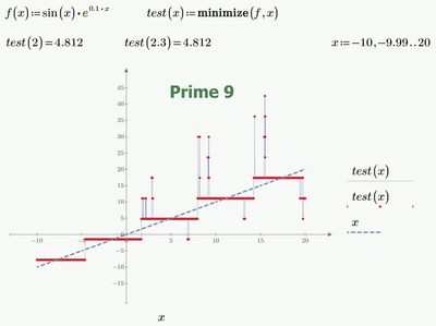

The reason sure is the underlying numerical algorithm chosen by PTC to implement 😉
As PTC did not provide a detailed reference to the algorithm and because we don't have access to the source code of Prime, we can't say more as an answer.
@ttokoro  just mentioned that PTC seems to have changed the algorithm with Prime 10. Here is a comparison of the two with the minima of the function you provided. The differences are clearly recognizable. And in both versions you have sort of outliers.
File in P9 format attached
