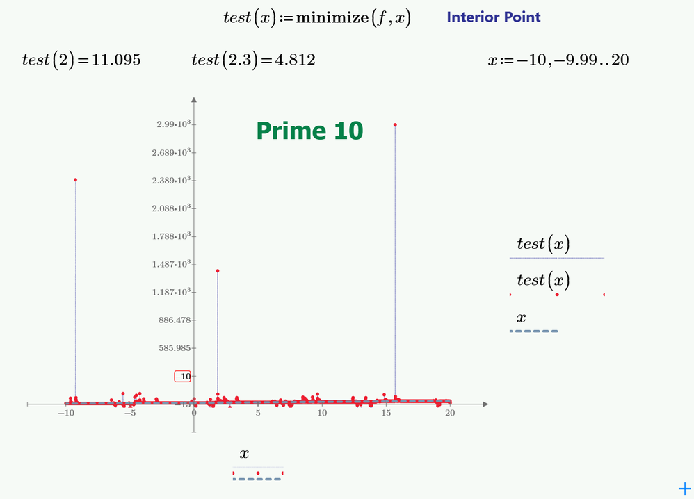

What could be the reason of which when setting g:=2 the first local minimum is taken as 11.095 (so jumps/skips over the first local minimum), but when using g:=2.3 the first local minimum is taken as 4.812, so the first minimum expected one value around 2.3 value. I would expected to see the first local minimum as 4.812 when using g:=2 as well.
My understanding is that by setting g:=some value, then maximize(f,g), and minimize(f,z) mathcad functions will take the first local maximum and the first local minimum around this g given value. Is not right my understanding?

The reason sure is the underlying numerical algorithm chosen by PTC to implement 😉
As PTC did not provide a detailed reference to the algorithm and because we don't have access to the source code of Prime, we can't say more as an answer.
@ttokoro  just mentioned that PTC seems to have changed the algorithm with Prime 10. Here is a comparison of the two with the minima of the function you provided. The differences are clearly recognizable. And in both versions you have sort of outliers.
File in P9 format attached

Mathcad Prime 10 uses the KNITRO solvers, which do (allegedly) differ from the previous MP solvers to a degree.  See https://en.wikipedia.org/wiki/Artelys_Knitro and MP10 Help for further information.
You can choose which of the available solvers to use by right-clicking on minimize/maximize and selecting from the context menu.

Ahh, I forgot that in P10 we got back the ability to chose an algorithm.
But none of the algorithms in P10 duplicates the behaviour of the algorithm used in P9.
Additionally as far as I am aware, the KNITRO algorithm were implemented from the very start of Prime, also in lower versions. At least the help in P4 already states that (amongst others) "minimize" is now based on KNITRO.  So this does not explain the differences between P9 and P10.
So it still seems that PTC has modified the underlying algorithm in P10. From the plots I showed it looks like P10 is a little bit less 'erratic' concerning the initial guess value.

I could not find this in the help, but if the helps claims that LM would be available for "miminize" and "maximize", then thats wrong. These two functions seem to default to "conjugate gradients" rather than to LM (wich is not among the choice list).
BTW, the same applies to real Mathcad as well were LM was not available for "minimize" and "maximize".
