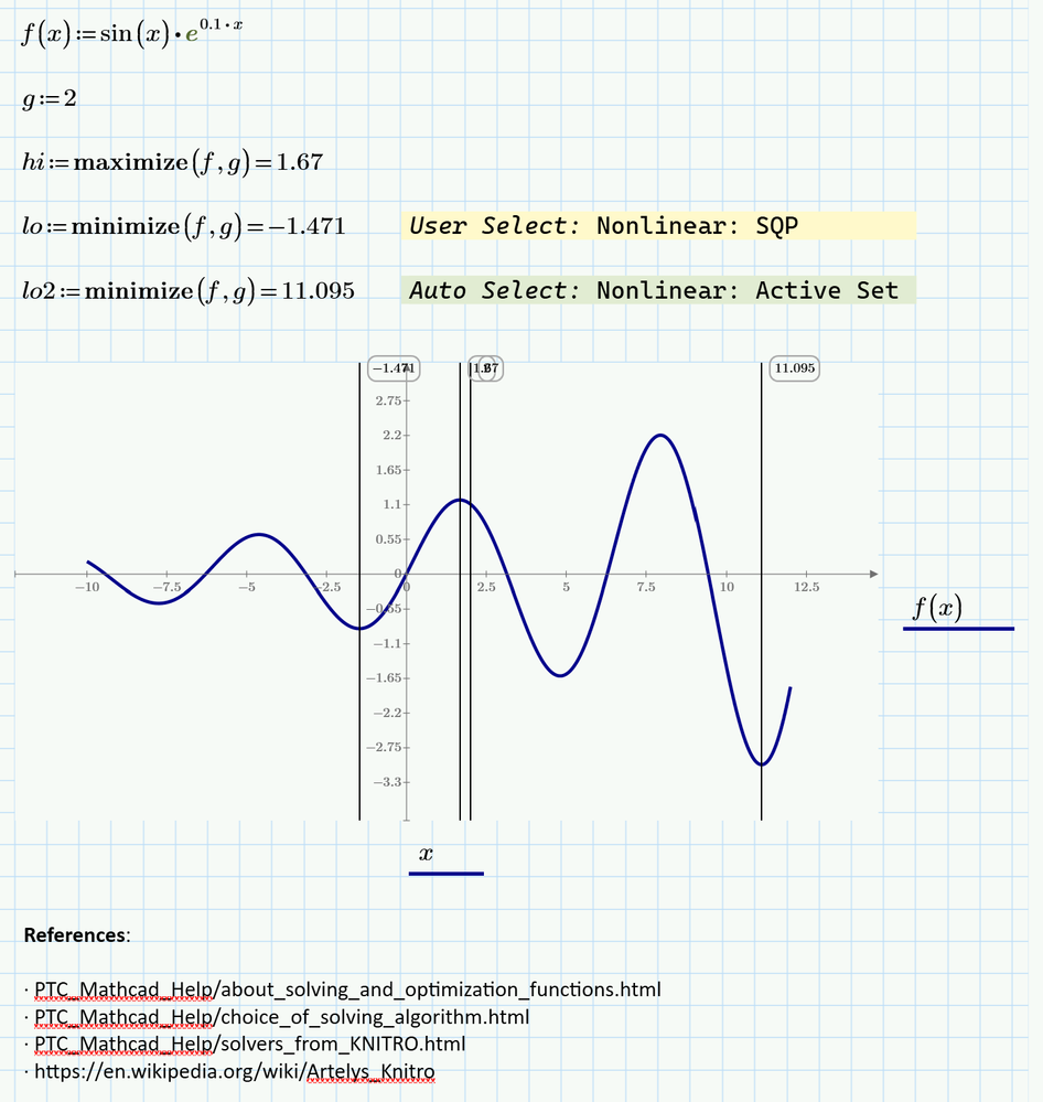

What could be the reason of which when setting g:=2 the first local minimum is taken as 11.095 (so jumps/skips over the first local minimum), but when using g:=2.3 the first local minimum is taken as 4.812, so the first minimum expected one value around 2.3 value. I would expected to see the first local minimum as 4.812 when using g:=2 as well.
My understanding is that by setting g:=some value, then maximize(f,g), and minimize(f,z) mathcad functions will take the first local maximum and the first local minimum around this g given value. Is not right my understanding?

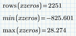

An alternate option for the zeros:
Advantage is higher precision
On the other side we get a very large vector with a lot of duplicate values and also values outside of the desired range
And because we rely on the algorithm used by the "root" function, we cannot be absolutely sure that with our selection of x-values (guesses) we can really catch ALL zeros within that range.

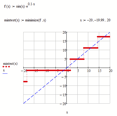

LucMeekes
(To:Werner_E)
Guess I'll stick with Mathcad 11 for serious work:
(Method is Nonlinear -> Conjugate gradient, by default)
That's sure a wise decision 🙂
BTW, MC15 is showing the very same behavior as your MC11. No unexpected "outliers", no matter which nonlinear algorithm (Conjugate Gradient or Quasi-Newton) we chose.
But it looks like Mathcad has troubles finding the minima at x=-7.754 and x=-14.037.
Here Prime 10 is doing a better job (despite its erratic outliers)

Mathcad Prime 10 uses the KNITRO solvers, which do (allegedly) differ from the previous MP solvers to a degree.  See https://en.wikipedia.org/wiki/Artelys_Knitro and MP10 Help for further information.
You can choose which of the available solvers to use by right-clicking on minimize/maximize and selecting from the context menu.
Stuart

(To:StuartBruff)
Ahh, I forgot that in P10 we got back the ability to chose an algorithm.
But none of the algorithms in P10 duplicates the behaviour of the algorithm used in P9.
Additionally as far as I am aware, the KNITRO algorithm were implemented from the very start of Prime, also in lower versions. At least the help in P4 already states that (amongst others) "minimize" is now based on KNITRO.  So this does not explain the differences between P9 and P10.
So it still seems that PTC has modified the underlying algorithm in P10. From the plots I showed it looks like P10 is a little bit less 'erratic' concerning the initial guess value.
