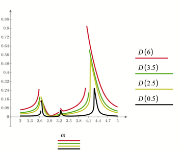

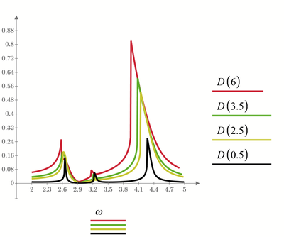

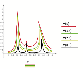

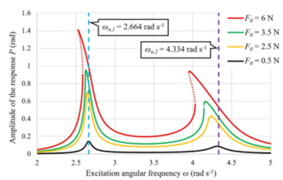

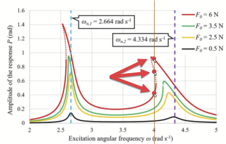

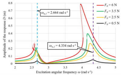

Many thanks for the corrections Terry and in depth look into my problem Werner. The problem is  non-linear involving a ball tuned mass damper rolling in a semi-circular track mounted to a structure that is vibrating. In Terry's sheet I have included equations for rotation of the ball (P) and translation of the base structure (D).
The response is sensitive to the amplitude of force (Fo) and becomes more non-linear as Fo increases with jumps in response- see plots below of what occurs.
Werner, the values you are trapping with NaN would appear to be the values of omega that fall within this non-linear jump zone. I note that Terry's program fails to give a solution when Fo is > 3.5 N. It would be nice to be able to plot the P and D curves for higher values of Fo up to the points where the jump occurs. This would require smaller increments in omega as the solution approaches the jump.

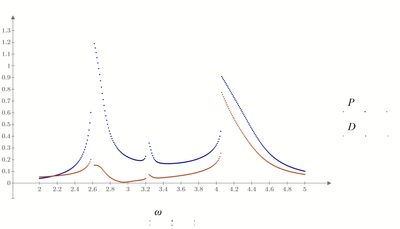

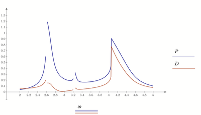

I set F0 to 5 and ran the frequencies from 2 to 5, with a smaller step size of only 0.01. Of the 301 frequencies generated in this way, the solve block failed to find a solution for just six – three around w=2.6 and three around w=3.22 (with a step size of 0.001, already 27 frequencies fail).
The corresponding graphs therefore look like this:
or by just drawing the points and not connecting them like this
The method of course also works for F0 larger than 3.5.
But if your goal is to duplicate the graphs you have embedded, I see another, more serious problem. What the graphics show are not functions (just one unique value for each argument). For some curves, I see several amplitude values for some frequencies. Here, for example, there are three values for the red trace at w=4.
However, a numerical solution block always gives you only just one solution (if any 🙂 ), even if the system should have several solutions. Which solution you get depends on the guess values used.
So you would have to call the solution block with different guess values for each frequency w in order to obtain these different solutions, and you would have to know from your application (and you probably don't) which guesses you should use. I imagine that would be rather difficult.

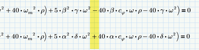

I noticed that your first and second equation look quite equal apart from the variables used - with one exception:
Is the different sign done on purpose?
Its doesn't change anything concerning the main problem, though.

BTW the sign change in the two equations you highlighted is correct.

The dimensions in your equations are not compatible.  For example, in:
the units of the first term are seconds^-2, those of the second are metres.seconds^-2 (unless your values 10 and/or 56 have undeclared units also).  You would have seen this immediately if you had actually assigned units to your variables when you defined them, instead of just writing them separately as text.
