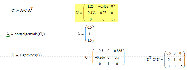

to all math experts,
I have started looking at a method involving PSD and co-variance matrices. I am trying to set-up an example in mathcad (15) out inf interest and struggling with an eigenvalue extraction. I think I need to "invert" the problem but don't know how. Attached mcad15 file and a pdf. see sheets 4 & 5
Some pointers on my ignorance would be welcome

See file.
The error is U is undefined.
Here is solution.

See file.
Here is solution.

Thanks a lot. 1 problem sorted. Now to the next one....
