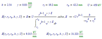

I am trying to solve an equation like:
this one can't be solved analytically and a priori the solve block does not work correctly (in the way I use it.
see attached file
Any idea how to solve this equation
Thank you,
I have followed your advise and evaluate first the integral and than insert it in the equation for the E-field.
I do not understand why, but this cuts the calculation time significantly and allows the use of a programmed loop.

I think that you can iterate and approximate a better solution.  Attached is your file (very nice, BTW) with my scribbles on the end.  I have only Express, so a solve block won't work for me, but the root function is a nice   alternative.  Now, the problem with this solution is that it forces a constant value for E, so the integral isn't right.  So the first iteration is to replace that constant value in the integral with the solution value.  This yields a significantly different curve shape.  I did one more iteration (you can continue to iterate, plugging in each successive solution to get the next.  Whether or not this produces a better answer or not is beyond my scope.
File in Prime 7.0 attached.  Good luck!

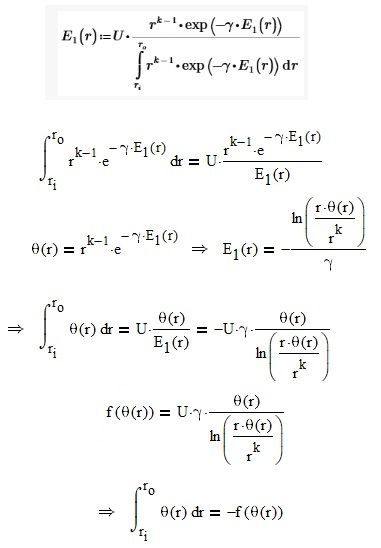

LucMeekes
(To:THAE)
Apparently you need a mightier Mathcad to solve this:
The numeric solution of your solve block is close.
The solution is pretty obvious. With E and gamma not dependent on r, you can take the exp(-gamma*E) out of the integral, and cross it off against the same in the numerator. The primitive of r^(k-1) is r^k/k.
Now to eq(1), If you take the derivative of both sides to r, you get a differential equation which may be solvable.
Here's one try:
Solve it to get:
Prove this solves the differential equation:
OK. The next challenge is to determine the integration constant c1.
