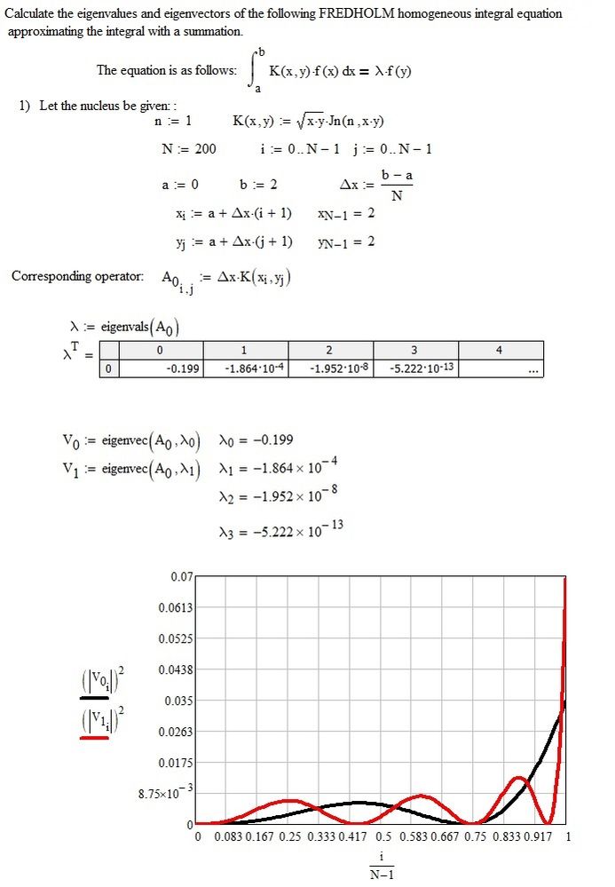

Since, in the equation, the unknown function appears as an argument of the integral, then the equation is an integral equation. You have to see what kind of integral equation it is (for example Fredholm, Volterra, Wiener-Hopf, ...). For a numerical solution you simply have to discretize the integral which becomes a matrix. An eigenvalue equation should come out. Anyway, search the internet for integral equations.

An elementary example of a numerical solution of a homogeneous Fredholm equation. The discretized integral equation is transformed into an eigenvalue equation. The eigenvectors corresponding to each eigenvalue are the discretized orthonormalized solutions of the given integral equation.
-MFra-
