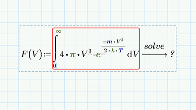

Hello, we're trying to solve integral equations, and there's error on getting the final integral value in Mathcad. anyone can direct how to get the following integration done in Mathcad?
There's a following error: More than one independent variable for keyword solve.

Change the label of  m and T to variable (they are now seen as a units), and remove the directive solve.
You should see that Prime produces the result of the integral, if it exists, which I expect to be independent of V.

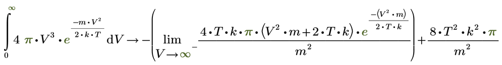

So now suddenly the integration runs from minus infinity to plus infinity instead of from 0 to infinity...?
The answer you your original integral should be
4 . Pi . (k . T / m)^2.
Correction:
8.pi.(k.T/m)^2

Here goes:
That's Mathcad 11.
In Prime 7 you get:
You have to apply mathematical knowledge: in the end (at infinity) the exponential always wins over any power, so the limit results in 0.
It is time they build that into Prime...
