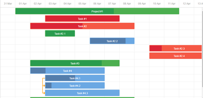

I need something like a Gantt Char showing labels inside the bars, between two specific dates and times. Thank's
