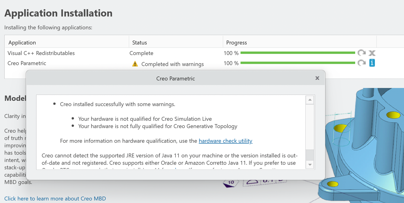

Can't open Creo Parametric 10.0.0
Have tried to open the installed Creo app and it won't even run - it doesn't respond at all. I also got an installation warning message saying my computer won't support some of the simulation software, but I don't think this is the main problem. I am also running this on Parallels because I have a Mac with an M1 chip.
PTC does not support Mac with an M1 chip.
Please read https://community.ptc.com/t5/PTC-Education-Forum/Can-t-open-Creo-Parametric-9-0-0-0/m-p/882216 discussion. It contains information that:
