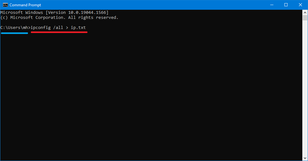

Every INCREMENT block contains HOSTID=PTC_HOSTID=xx-xx-xx-xx-xx-xx key, where xx-xx-xx-xx-xx-xx is physical address of network card.
It is necessary to check whether xx-xx-xx-xx-xx-xx is equal to physical address of your network card.
Network card information can be displayed using command ipconfig /all
You can also forward information into ip.txt file using command ipconfig /all > ip.txt
If you will send me BK800908EDSTUDENTEDUNI_license.dat and ip.txt, I can provide you more information.

license file sw_license_email_5666539.dat contains CREOPMA_Student6 license, that's OK.
License CREOPMA_Student6 is generated for Creo 7.0 and for physical address of network card C6-D7-8A-1F-9A-EB
Please run following command from Command prompt window at home and at university, too.
In my case the file is saved in C:\Users\mh directory.
It is necessary to check whether ip_home.txt and ip_uni.txt contains physical address C6-D7-8A-1F-9A-EB
Please upload both files.
Martin Hanák
