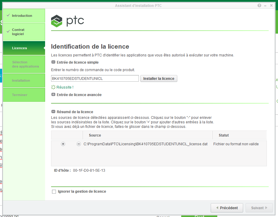

I download CREO4 for student.
But, i have an error when i try to install the licence.
 I follow the roadmap write here:
https://community.ptc.com/t5/PTC-Academic-Program-Discussions/Licence-Issue/m-p/536850#M9685%3F&art_lang=en&posno=2&q=student%20licence&source=search
But my issue remains.
Could you help me?
unfortunatelly I can't tell you what is wrong on your PC (Windows 10?). I can't find anything suspicious in your ip.txt file.
You can try:
  • disable all disconnected cards ... if you do not see them in Computer Management > Device Manager dialog box, you have to click View > Show hidden devices
  • disable IPv6 communication

You are awesome.
Yes, my computer is on W10.
I did your modification on my network card and  i obtain a licence.
Many thanks for your advice 🙂
