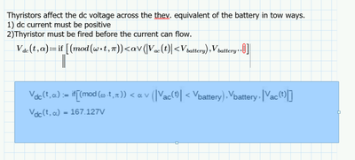

I'm trying to type this conditional statement and I don't know how to. Could someone please help me type this function?
I need a comma after V-battery and then an absolute value before the closing bracket, and PTC doesn't let me type that.
I tried that too, but still I can't get to what its supposed to be...

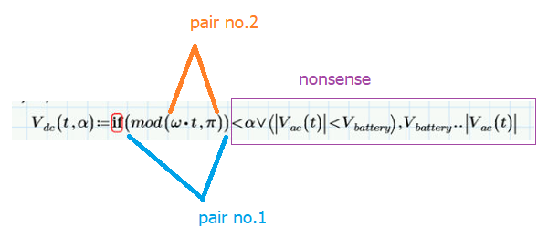

do not use square brackets, use parentheses.
and in my book, it is using square brackets.
Intro to power electronics and motor control page 718.

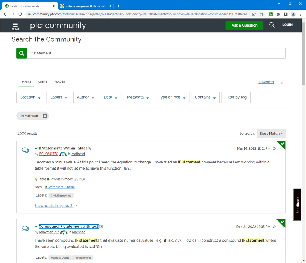

please study help pages to understand if command.
https://support.ptc.com/help/mathcad/r9.0/en/#page/PTC_Mathcad_Help/using_conditional_statements.html
https://youtu.be/2kY-pGKPAM0
You can also search community web to get more information.
https://community.ptc.com/t5/Mathcad/Compound-IF-statement-with-text/m-p/845500

if command syntax in your expression is incorrect, use something like this if(mod(omega*t,pi),"true","false")
