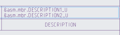

I just click on the cell and then properties. The Note Properties window coms up and I enter the text needed.

Found out that if you put all of that in a single line in the the note properties window, it reports as a single line on the BOM so ne need for smaller font.

That is one way, but we wanted to keep the width of the column down.
Plus it allowed us to show it as 2 different bits of information that we have defined for each description line.

You can also put both lines in the BOM format cell.
(different formats, but same principle)
We use a slightly smaller font (.140 instead of .156) on D & E formats, but still readable.
