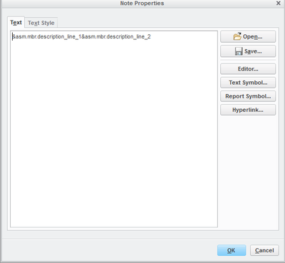

You add them both together like the following:
&asm.mbr.description_line_1&asm.mbr.description_line_2

Thanks for the quick reply. I tried doing this and it seems I run out of character space.
I get to here: description_line_1&description_ and it wont accept any more characters.

Hi Ben,
Thanks for the info, just what I needed.
Found out that if you put all of that in a single line in the the note properties window, it reports as a single line on the BOM so ne need for smaller font.
