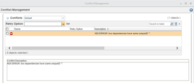

NDI ERROR: two dependencies have same uniqueID "".
1. What version of the software are you running?
CREO 5.0.4.0
2. What is the problem?
I get the error:    NDI ERROR: two dependencies have same uniqueID "".
But have no idea how to find these two dependencies that are generating this error.

SM_10398034
(To:StephenW)
Thanks - but I've read the post associated with the link provided - and that clearly identifies the offending part, while the error I received does not.   The second solution appears to be related to drawings (my error is associated with an .ASM model.)  Ideally, I'd like to follow the first procedure to attempt to resolve the issue - but I don't know how to find the dependencies that have the duplicate unique IDs.  Any thoughts on how I might find that out?  It seems CREO can do it, and lets me know, but doesn't want to share this info???  Greatly appreciate the help.

I've dealt with these over the years and I don't remember having one that didn't say what model was the problem. These are extraordinarily frustrating errors even when you know the problem file(s). I'm going to suggest to leave this post here and open for discussion but also open another post on the windchill forum, since the error is associated to windchill. https://community.ptc.com/t5/Windchill/bd-p/Windchill
You might be able to work thru which file(s) are causing the issue based on check in. Check in lower level parts/ assemblies until you find the one that won't check in/upload.
We still have a list of files that may have this problem that when changes are necessary, we don't just let anyone work on them, has to be someone who knows how to jump thru the hoops.
