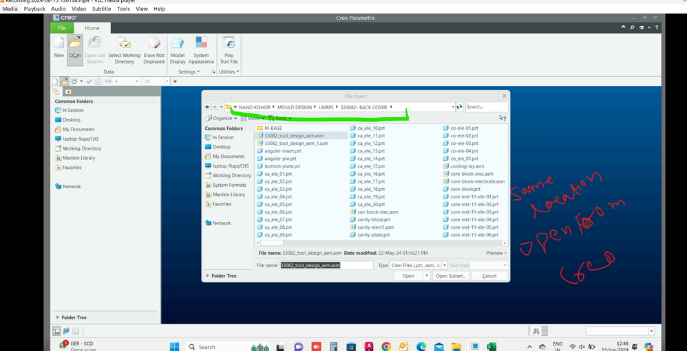

I am facing an issue model part does not show in the folder, but the same model shows when opened c
chandan
I am using Creo Parametric Release 9.0 and Datecode9.0.2.0
I am facing an issue model part does not show in the folder, and the same model shows when opened in Creo
Here are the errors that I faced
hello

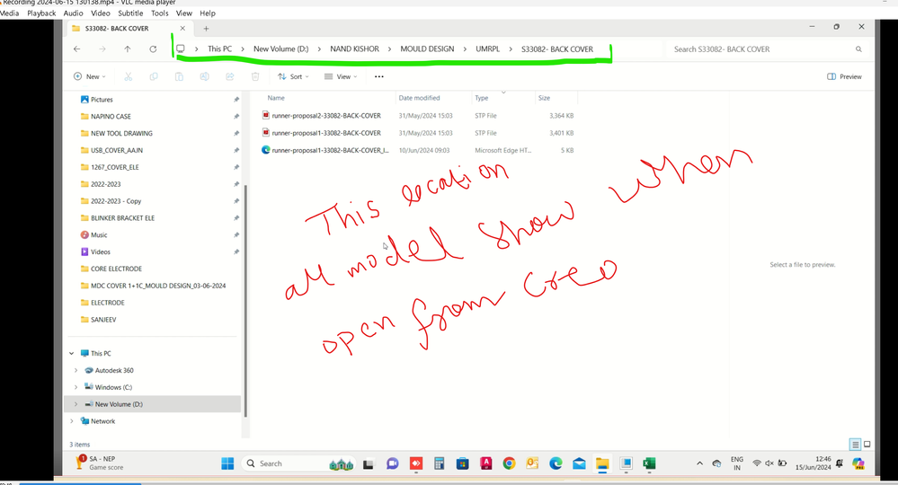

In my system the same name of two folders created at the same location. I don't know how this happened. after this, I set the working directory in the same folder and worked on the project after that do not show the model in this working directory and then rename this folder problem solved

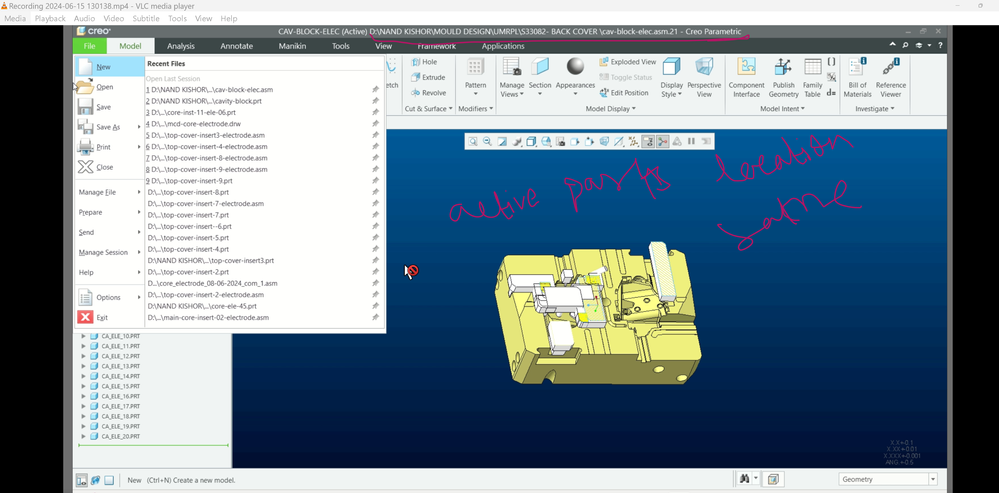

If you have search paths in any config file, it could be finding the part.
If you have already opened the part in a different folder and didn't erase memory before changing working directories.

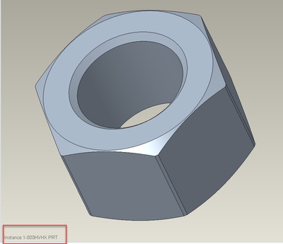

If the part is a family table instance, the only file in the folder will be the generic model. One way to tell if it is a family table part is to open the part by itself and look in the bottom LH corner, if it says "instance", then it is part of a family table.
i attached image related to the issue
With Regards,
Chandan Kumar
Mob.+91-9708668072
StephenW
(To:chandan)
@chandan
It seems there is no image
you can either copy and paste and image in to the body of the post.
or
you can attach a file using the insert photo icon
sure this image paste can you see this image
upload_-SU1BR0UxLnBuZw==-7232309987224691819..pngupload_-My5wbmc=-5734197720358013577..pngupload_-SU1BR0UucG5n-6262700942116923655..png

I have fixed the issue.
Actually this was a window issue

hello
