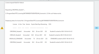

License request failed for feature
The message:

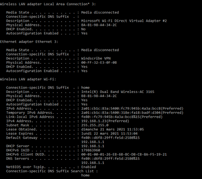

Hi, I've been reeding some similar topics but none of them helped me solve my problem.
What sould I do ?

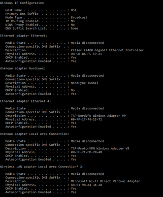

There is my ipconfig/all:

Run the utility PTCstatus and see what IP address that gives. This is the address that must be used in your license file. Your #1 wireless address may not be the one that PTCstatus returns.

edit parametric.psf file in Notepad.
Replace CREOPMA_Student7 with CREOPMA_Student6
Martin Hanák
 Not sure if this would help, but I have Mac and use parallels and had this issue. All I did was run the program directly from the folder it's in, not from the icon on the desktop screen.
To make it work all I did was find Creo in the windows folder (not command window). For me it was in PC:Program Files:PTC:Creo
and then you should see a folder called "Parametric"-click into it. Then inside that click into the "bin" folder. Then just double click "Parametric" that is APP type.
Hope that helps.
