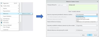

This might be too late, but there is an option in each individual part(need to confirm this).
What i found was (in Creo 4.0) :
References->Reference Control-> In "Reference Creation Control" window, change the "External components permitted for reference creation:" option to what you want.
