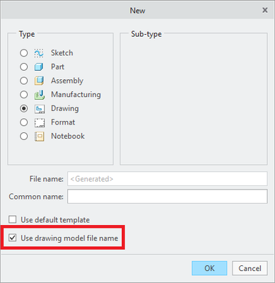

Mapkeys are static. IE whatever you click on and type into a box is what gets recorded into the mapkey with no changes.  Can you go the other way? Starting with Creo 6 there is an option to make the drawing name the same as the part/assembly name. Another complicated option is to call a mapkey which then calls an outside script which writes another mapkey. Doing this you can make dynamic mapkeys with the outside script. I wrote an example of this here.
Chris3
(To:Chris3)
Something I forgot to mention, you can use wildcards in the filename box. See below. Doing this will limit what shows up in the dialog box. However I am pretty sure what gets recorded in the mapkey is the filename of whatever you pick when you pick a selection so I don't think this will help. Similarly you can search using the search in the upper right hand corner but again, I am pretty sure the filename that you pick is what gets recorded in the mapkey.
