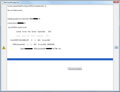

When trying to start WildFire 4.0 I get the following error.
How can I run WF4 against Creo license server?
you have to modify startup file located in <PROE_loadpoint>\bin directory. Its name is probably proe1.psf (I am not sure about this).
  • open the file in Notepad
  • locate PROE_FoundationAdv string
  • replace it with PROE_EssentialsM
  • save the file
  • start WF4

It looks like the 1 PRO_Essentials license is already in use.
Check the PSF file to see in what order the licenses are being pulled.
Might need to add the Expert Machining license to the list.
