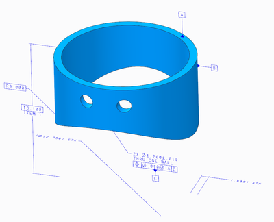

  • When trying to convert an existing drawing to true type fonts, I can get all the symbols to update to the new font by modifying the parts and assembly files, except for the plus minus symbol.
    • Does anyone have a method to update this symbol on an existing drawing?davehaigh_0-1602707327808.png
    • The strange thing is, If you create a new drawing, then this symbol displays in the true type font.
      • Obviously creating a new drawing is a non-starter when revising existing drawings!

For example I have an assy of two parts that is a weldment. All of these files have to change to use True Type Fonts in the drawing. I would have expected the change in the drawing would have been all that was necessary. That fact that the display in the drawing is linked to the display in the models is a problem. At least the way I think about this it's a problem.

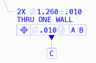

If I go into the drawing detail setup file and modify the default_annotation_font to a .ttf font, and the symbol_font to asme, I get these results.

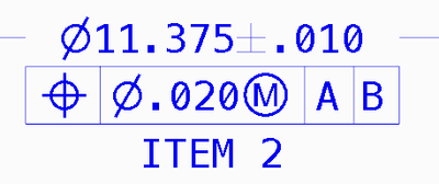

Notice that the,
  • diameter symbols,
  • the MMC modifier, and
  • the plus minus are still stroked.
I have to open up the model that dimension was shown from, and modify the detail setup file to show the .ttf font and symbol_font as asme.
Which results in all but the plus minus symbol showing correctly in the drawing.
However if I look at a dimension that was shown from the other part in the weldment, it’s still messed up.
I have to go modify that part’s detail setup file also, after which I get this. But I know of no way to get the Plus Minus symbol to update to the True Type Font. GRRRRR!
If I create a new drawing and show that dimension, then it shows the Plus Minus in the .ttf font.
So instead of just changing the settings in the model, I have to change the settings, in this case. on 2 parts, 1 assy, and the drawing assuming there is a workaround for the Plus Minus Symbol. If not then I have to create a new the drawing in order to get that symbol to change to a True Type Font.
This may not be a huge issue when talking about a 2 part weldment. But considering we have some 30 page weldment drawings… this is a non-starter. The designers would run me out of town on a rail.

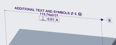

MBE Considerations
My next consideration was why not change the MBE annotations to use the standard font instead of the default win_font.ndx, have it use font.ndx
So I change the default_annotation_font to font.ndx and the symbol_font to stroked_asme.
And that works. The model dimensions shown as annotations show in the same font as we’ve used for drawings all these years. To me this is a viable option that keeps the font the same in drawings and MBE.
So my question is…
  • Will this font present a problem for down stream applications reading the model. Either with the native model, or a derivative step file.

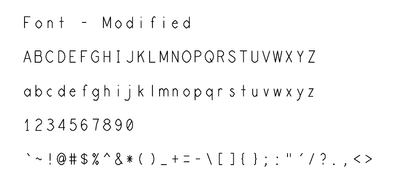

If you look at the source file for standard font you will see that is defined as 16 x 16 with a base line at 4.
In our standard font, this is what the definition for the zero looks like on the 16x16 grid. I’m showing both the existing slash that extends beyond the outline, and a slash that stays inside the outline.
The font could easily be update by changing of these two lines in the source and then recompiling the source.

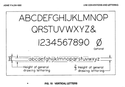

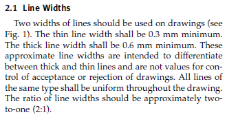

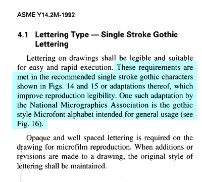

Standards – What they say about drawing fonts
The following is what the standard have to say about fonts on drawings. The standard shows the Zero with the slash as extending past the outline of the zero. Which I’d forgotten when I created the graph image above.
However the true type fonts with the slash in the zero, keep the slash inside the outline.
I believe the slash inside is the better look, but if you want to be a stickler about the standard that is wrong unless there is an update to the standard I’m not aware of.
The two modified stroked fonts are attached. One with the slash inside and one with it outside. The other characters I and 1 are also modified.

2.)  ASME Y14.2-2008 dropped that line about National Micrographics 'Microfont'.

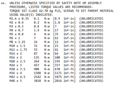

We want tables of numbers to line up. Think of a spline defined by points to a very high precision. A cam would be a good example.
We also have notes like this where we want this information to be in columns for easy readability.
Currently the only mono-spaced fonts PTC supplies are stroked fonts. As shown in the left column below.

Our Standard Stroked font – PDF output from Creo

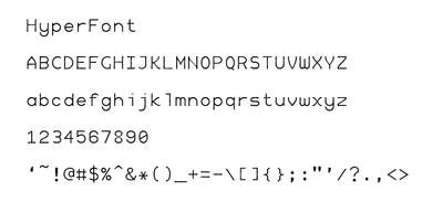

Hyper Font – PDF output from Creo – I like this because it’s not much thicker than the current font. I thing there is some weirdness in the 8 where it thins down too much in the middle. Same issue on the upper case N.

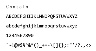

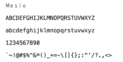

Meslo – A windows version of the Menlo font – PDF output from Creo – Too my eye this is too bold.
Consola – Standard Windows Font – PDF output from Creo – Same issue, this is too bold. Also the lower case italic i & j look weird, although I don’t recall ever using italic on a drawing.

NOTE:  All of these mapkeys below are what I would consider experimental as I've only recently begun the trip down Creo's ttf lane.
Interesting anomaly about the mapkeys issue.  Because Creo 7.0 has graphical slowdown when using TrueType fonts I created mapkeys to switch between ttf & stroked.  Maybe you can compare and modify mine to work for you.
mapkey ttf @MAPKEY_LABELTrueType Font;\
mapkey(continued) ~ Command `ProCmdDwgProperties` ;\
mapkey(continued) ~ Activate `mdlprops_dlg` `OPTIONS_lay_Controls.push_Change.lay_instance`;\
mapkey(continued) ~ Input `preferences` `InputOpt` `default_annotation_font`;\
mapkey(continued) ~ Input `preferences` `EditPanel` `inconsolata-regular.ttf`;\
mapkey(continued) ~ Activate `preferences` `AddOpt`;\
mapkey(continued) ~ Input `preferences` `InputOpt` `symbol_font`;\
mapkey(continued) ~ Input `preferences` `EditPanel` `asme`;\
mapkey(continued) ~ Activate `preferences` `ok`;\
mapkey(continued) ~ Activate `mdlprops_dlg` `DlgClose_push`;
mapkey ttr @MAPKEY_LABELStroke Font;\
mapkey(continued) ~ Input `preferences` `EditPanel` `font.ndx`;\
A mapkey to open the active drawing model and change the symbol font to asme (ttf).
mapkey fixmdlttf @MAPKEY_LABELFix MDL TTF;\
mapkey(continued) ~ Select `main_dlg_cur` `PHTLeft.AssyTree` 1 `node0`;\
mapkey(continued) ~ Open `main_dlg_cur` `PM_PHTLeft.AssyTree`;\
mapkey(continued) ~ Command `ProCmdOpenModel@PopupMenuTree`;\
mapkey(continued) ~ Activate `open_instance` `open`;\
mapkey(continued) ~ Command `ProCmdMmModelProperties` ;\
mapkey(continued) ~ Activate `mdlprops_dlg` `DlgClose_push`;\
mapkey(continued) ~ Command `ProCmdWinCloseGroup`;\
mapkey(continued) @MANUAL_PAUSEModel should now use TTF symbol fonts.;
