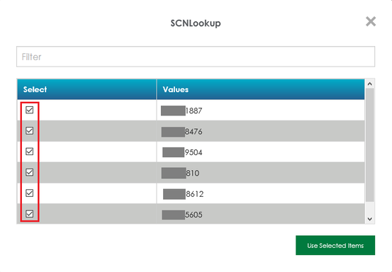

You may find it easier to use the 'Advanced Search' and just select all SCNs:

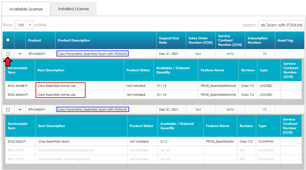

Each product that includes a home use license will have a double row.  One row for the 'normal' license and one row for the 'home use' license:

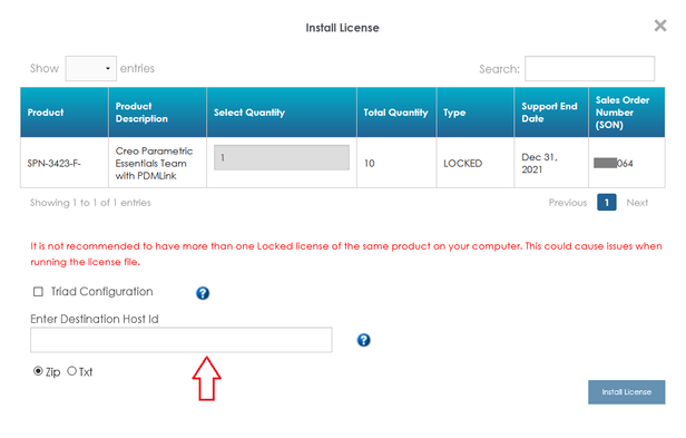

To install, select the row with the home use license (red arrow above) and then choose 'Install License'.  On the pop up dialog you will need to enter the MAC address for the home computer.
Once you enter the address and choose 'Install License', a license file will be emailed to you.  That license can then be used to run Creo on that home computer.
