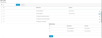

I came accross similar difficulty to have every single row, that I edited, to list to another Grid (just to check what was edited), but this is for the new Grid  widget (in 9.3) which is themable,
  • The issue I faced was that If I edited a cell in the main table, the row with the edited cell data was displayed in the other grid correctly (I bound the EditedData property to the other grid table data)
  • However if I edited another cell data or row data, the "EditedData" in the other table was lost and only the new edits appears. (I wanted to have all of the data which was edited in my main table).
  • After some testing, I can say the the solution is in the Main Table property, called "EditLevel".
    • It has 3 values, "Entire Grid, Single Row, Single Cell".  In the begining I thought that the "Single Cell" is what I'm looking for, because I wanted to edit only a single cell. However this caused the confusion.
    • If you select either "Single Row" or "Single Cell" , only that specific row, or cell value will be the output of the "EditedData", and it will onl keep the on row or cell data  and not keeping previously edited cells/rows.
    • You should use "Entire Grid" to have all the modifications, on all rows or cells. This way the edited data will keep all of them, and you can save the edited data at once
Hope it helps a bit.

Enable the following in grid properties,
  • isEditable --> true
  • Change the EditLevel based on the you requirement (Entire Grid, Single Row, Single Cell)
  • Go to Grid configuration (settings icon) --> select required column to edit --> Make Editable to true
  • RowSelection --> Multiple
You able to see the check boxes in the grid and edit button also. For more.
