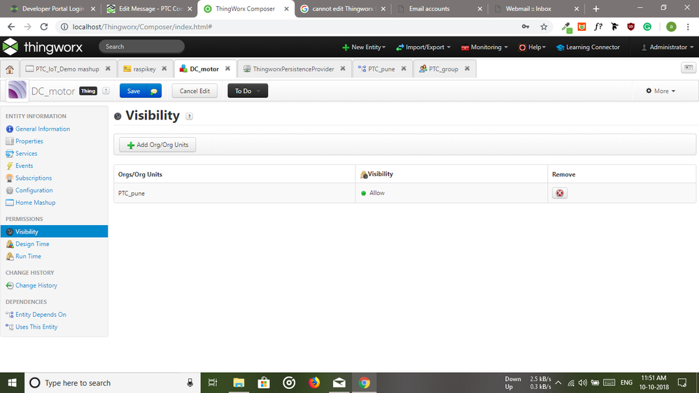

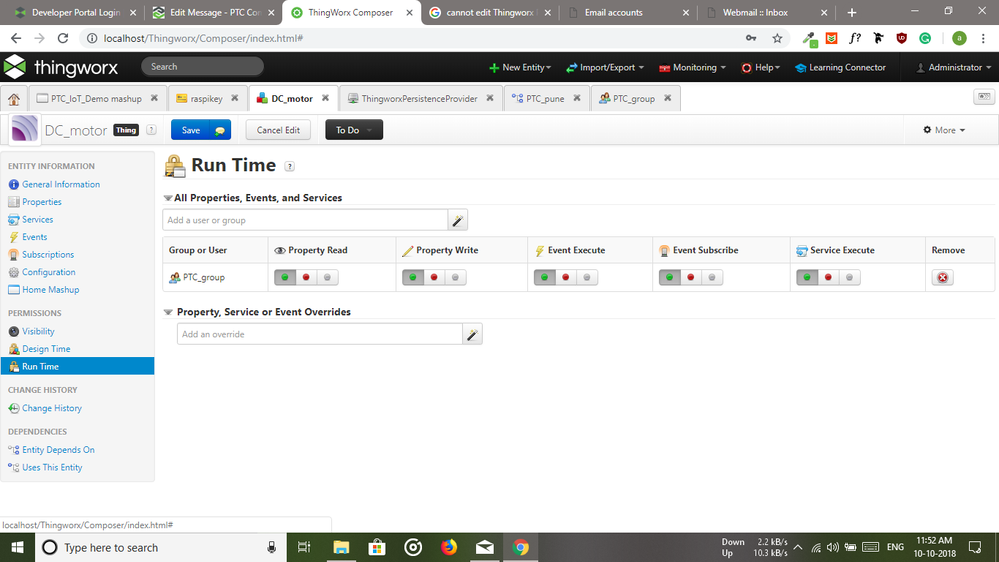

i'm using mqtt thing with some data from mqtt server in thingworx. i made two alerts in mqtt thing one is for above 50 and one is for below 50. when sensor data come from mqtt server and it is either above 50 or below 50 this alerts does not trigger. but when disconnected from mqtt server and set the thing property by manually above 50 or below 50 it triggers alerts. strange but is happening with me. please help with this.

What is your ThingWorx platform version? The issue looks to be this https://www.ptc.com/en/support/article?n=CS275831 If that is the case, you may either grant visibility to the system user or upgrade to the fixed version.

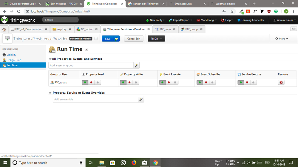

i saw the the link you gave. in that article it says  "Add Visibility for the System User on ThingworxPersistenceProvider.
i added visibility for whole group and organization for ThingworxPersistenceProvider but still problem exists.
my Thingworx version is 8.2.1-b140.

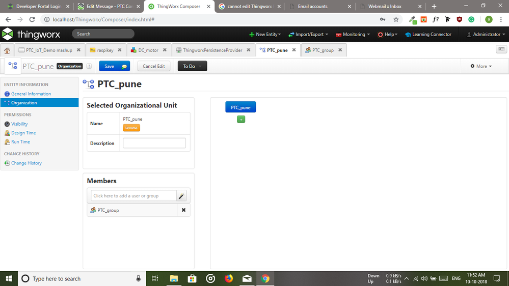

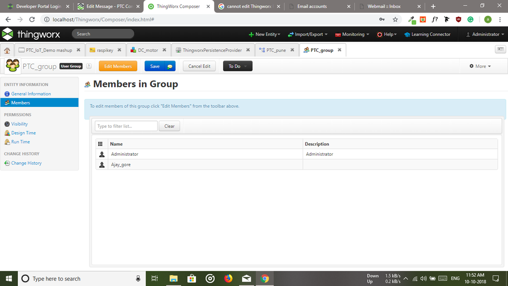

is the user "System User" part of the group and organization?
i have only two user, "Administrator" and "Ajay Gore" both are in the group and organization.
You have to enable showing of system objects as shownin the first screenshot attached.
Then when you search you will see System user (example in the second screenshot is from the next gen composer)
Thanks posipova, it solved the problem.
can you explain me why it is so..?  i didn't understand the visibility setting for persistence provider..? why we have to give visibility for persistence provider and some runtime permission for mqtt thing..?
Processing of messages when it arrives at the MQTTThing client is done as "System" user. There are certain operations during message processing that require the "ThingworxPersistenceProvider" to be visible to the "System" user. The fact that "ThingworxPersistenceProvider" does not have any visibility permissions set on it OOTB causes the issue being reported where DataChange events on properties that have alert definitions or bindings etc. set on them do not trigger those alerts or evaluate bindings.
