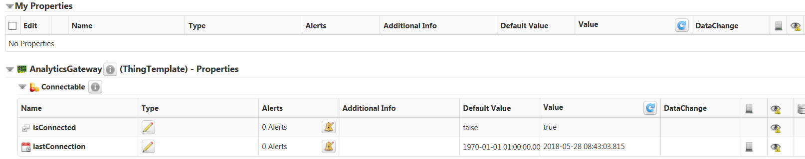

I installed ThingWorx Analytics Server 8.2.1 (AnalyticsServer Thing was created) and trying to install Analytics Extension 8.2.1.
After importing and configure (run configuration service, add TW_ML_Session_Variable) the extension in Foundation I am unable to configure communication settings in Analytics Builder.
The Analytics Thing can be selected but the connection is unsuccessful (logged in as Administrator) . Thingworx Foundation and Analytics both are running (on same machine).

Hi, Was your ML entity showing isconnected= true ? Did you find any logs from TWX or TWA side about it?
abiidesignss
(To:zyuan1)
thank you for your reply.
Entity is showing isconnected=true
and I get following Error in logs:
[context: com.thingworx.webservices.context.HttpExecutionContext@1afc3e31][message: Execution error in service script [GetDatasetsAMS] :: java.net.ConnectException: Connection timed out: connect]
please see attachment
Thank you
