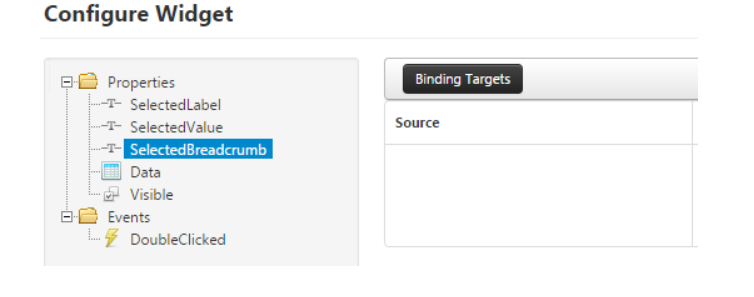

Use Tree grid Advanced. It has the selected rows as bindable input field.
anarwal
(To:ranjank)
@ranjank , Try writing a service  which returns me you child of first node(2nd level) and bind that data to selected label and value.
