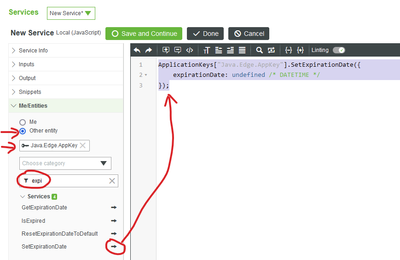

Hi Gary,
The documentation link you shared only lists the name of those services. It should not be considered by any means a complete reference to what's available as a service, just a sort of helper in the sense it's searchable in the Help Center.
The way you would refer to understand parameter names etc for these services, is to use the Service Editor, and in the lower tab, set the reference to "Other entity", then search for an entity of the type you want to "research" let's say.
As soon as you select one, you'll get complete access in the lower part to all the Properties, Services etc of that entity (technically it's correct to say to all public ones, as there are private services, as an example, which are not visible in Composer and not intended to be used by Developers - again, theoretically).
As soon as you pick a service to add it in the Service editor, it will be populated automatically with all its parameters.
This way is the fastest way in which you can really understand what services you can use for any entity type.
Note there's also the option to use the API Documentation in the Help Center, where you can get access to the same type of information, but, since I am using anyway the Service editor a lot, what I shared above it's the fastest way to do this type of "discovery".
