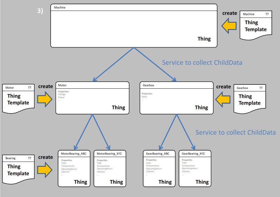

Principal Sketch 1) Real World Model Overview

On the other hand I can model the whole machine by using different Things for the parts and use Services to gater the information from all them.
Principal Sketch 3) many small things
I am not sure what is the best way. Maybe someone can share his/her experience on modelling such a job.

For what you say, I would chose the sub-things method (you can use Networks to relate the Things, as it's clearly a tree relationship)
