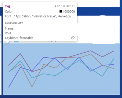

Can I adjust padding of LineChart Widgets?
AL_10742319
I have limitation of area
I have to custom adjust padding
and I have to set height of this (am not sure it's "svg" or "#chart")

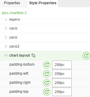

Hi @AL_10742319,
Have you enabled SparkView for Line Chart?
Have you tried configuring the paddings in Style Properties > chart-layout?
AL_10742319
(To:TonyZhang)
Thank you for answer!
I have enabled SparkView, but in Style Properties don't not have chart-layout
now I can adjust using the Custom CSS :
ptcs-chart-line::part(chart-layout) {
  padding: 0;
TonyZhang
(To:AL_10742319)
Great! looks like the padding is exposed through Style Properties > chart-layout since TWX 9.3.4, so it's not available in older versions.
