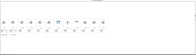

I have a collection widget with a few mashups in it;
But as you can see, for whatever reason the mashups start in the middle of the container.

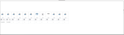

If I use the advanced size settings;
And set the growth ratio to 0, the collection widget itself disappears.
Is it even possible to have it start in the top left corner?

It seems like it was the FlowLayoutContentGravity that decided on where in the collection widget the row is, top, center or bottom.
