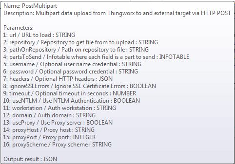

I am trying to manually import an XML file to the Thingworx Manual Importer feature using the service "PostMultipart" in the ContentLoaderFunctions resource.  Does anyone have any examples of using this service?
I have the needed file in the correct repository, however, the POST isn't doing anything.  I suspect I need to do something with the service parameter "partsToSend", but I don't know what.  I am not even sure what the structure of the InfoTable needs to be for that parameter.
Anyone have any ideas?

I did find that I need to include that header.  I have been able to successfully import an xml file using Postman, but I haven't had any success doing the same from a Thingworx service.
I could create a Java extension, but I'd rather use the standard platform if possible.

Here's the example on how to use PostMultipart from ContentLoaderFunctions:
  • To send the Request Parameters as text (InfoTable) :-
var table = Resources["InfoTableFunctions"].CreateInfoTable();
//Add new fields to the InfoTable:
table.AddField({name: "name", baseType: "TEXT"});
table.AddField({name: "email", baseType: "TEXT"});
table.AddField({name: "age", baseType: "NUMBER"});
// add data row
table.AddRow({
 email : "youremail@domain.com",
 age : 24
var params = {
	url: "http://www.example.com/api/yourservice" /* STRING */,
	partsToSend: table /* INFOTABLE */,
// result: JSON
var result = Resources["ContentLoaderFunctions"].PostMultipart(params);
  • To send the Request Parameters as file :-
var params = {
	repository: "FilesStorage" /* STRING */,
	pathOnRepository: "path/to/your/file/testfile.txt" /* STRING */,
// result: JSON
(Here value of repository represents the name of the FileRepository on your Thingworx Environment)
Hope it will help 🙂
