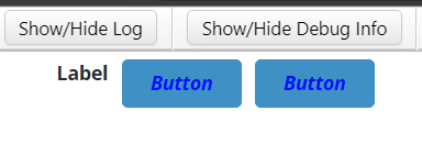

Hi
I'm trying to follow the new custom CSS syntax for Part
@supports (ptcs-style-unit: "PTCS-BUTTON.primary") {
 [part=label] {
 color: Blue;
 font-style: Italic;
Which affects all the buttons in the mashup
How to apply this custom CSS for specific button using CustomClass property
Thanks in advance
/VR

@VladimirN  Thanks for sharing this document. But I'm looking to implement new CSS syntax for specific button instead of whole buttons in mashup
TonyZhangCommunity ManagerAnswer
Support
July 11, 2023
Hi @Velkumar
You can use the DOM element ID to target a specific button rather than applying to all buttons.
Find out the ID from browser developer tool.
Use ptcs-style-unit: "elementID.PTCS-BUTTON"
Note that this syntax doesn't support class name to target the component for now, it's in the backlog and might be realized in the future.
Velkumar19-TanzaniteAuthor
July 11, 2023
Hi @TonyZhang
It works perfectly. Thanks 🙂
