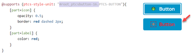

Hi @Velkumar
You can use the DOM element ID to target a specific button rather than applying to all buttons.
Find out the ID from browser developer tool.
Use ptcs-style-unit: "elementID.PTCS-BUTTON"
Note that this syntax doesn't support class name to target the component for now, it's in the backlog and might be realized in the future.

Hi @Velkumar
Tony
Velkumar
(To:TonyZhang)
Hi @TonyZhang
It works perfectly. Thanks
