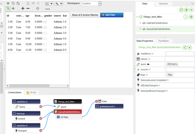

Hi ,
I have DataTable with some records , i want to use Data filter widget .but when i binds filter widget to "All Data" in Datatable Service . its showing field names in filter widget but unable to filter data. i need proper reference on it. which service needs to bind and which needs to create new one. i have attached screenshots plz see this and give some steps how we can get it.

I recommend to use QueryDataTableEntries and create bindings in the following order:
- bind the Query from Data Filter to Query from Parameters of service QueryDataTableEntries
- Change event of filter  bind it with QueryDataTableEntries service
See below:
See below:

Thank you very much . perfect !!
Hi raluca_edu,
Could you please expain how it can be done in infotable. If you give me binding connections it would be better.
Thank you
Bindings remain the same, the only thing is that you need to create a service that is getting all rows of an infotable and one service that is doing query in infotable. I do not have a code example for this, but for querying infotable you can use:

But you need to figure it out how to create a dynamic query for infotable that is selected by user and then to pass it to your service.
