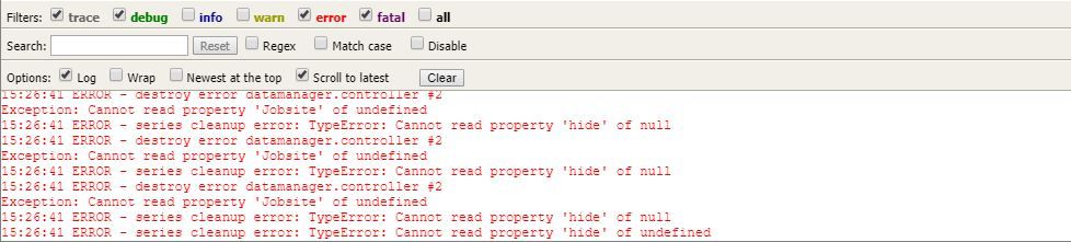

ERROR - series cleanup error: TypeError: Cannot read property 'hide' of null
iguerra
At every mashup change from menu I get the log above on the browser logs
I read old topics and seems was related to a google map extension, but seems not be the case (I removed also google map extension)
The pages are opened correctly, I have no errors on thingworx script or application logs
Sometimes the property name is not 'hide' but a property used on the pages, got from a data entity
It this something known ?
I have thingworx 8.5.3 cloud hosted
