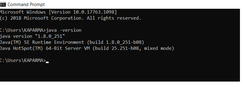

I have checked Java version ,which is ok

You do have a jdk 1.8 as return by your command java -version but you also have a jdk 14 which , unfortunately, is the one picked up by the installer, hence the failure.
Can you please uninstall JDK 14 and try again .

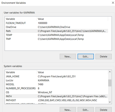

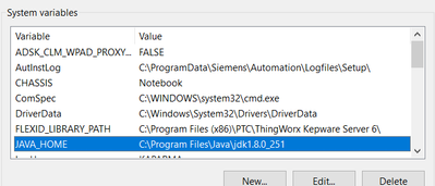

JDK 1.8 is Oracle JDK, correct? I figure as much, but can't hurt to check. Thingworx doesn't support OpenJDK. Also, did you create and set a JAVA_HOME system environment variable? And did you modify your Path system environment variable to point to JAVA_HOME\bin? See screenshots below.

@Kalpesh744 Also, I don't know if this makes a difference, but I have both jre 1.8 and JDK 1.8 installed. My system environment variable paths however are all pointing to JDK 1.8. Hope this helps!

Yup .It's Oracle JDK 1.8.I have already set JAVA_HOME in environment variable. It;s pointed at JDK file and yes, PATH in system is also pointed at JAVA_HOME.
atidwel
(To:Kalpesh744)
The system environment variable needs to be %JAVA_HOME%\bin - not just %JAVA_HOME%. I'm not sure what else is going wrong... that's all I did and the installer worked for me. Have you installed the trial version before using the same developer account? You can only have 1 trial version per account.
