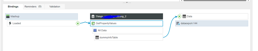

I read up on that Data Export Widget, but what is the best way to bind that?

You can bind the "QueryPropertyHistory" if you are looking to plot time history.

What if I'm not currently using Value Stream, and pulling from a thing itself, how would I bind that?
