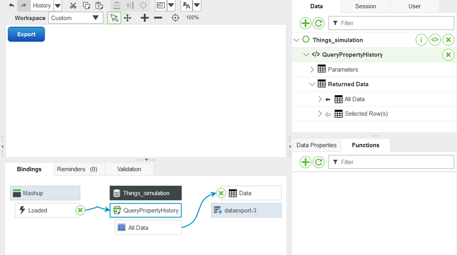

Thank you for your response, it is greatly appreciated. It definitely helped me to understand!
You can bind the "QueryPropertyHistory" if you are looking to plot time history.
Hi Kishore_K
With the QueryPropertyHIstory, am I able to export multiple types of data (ABCD....XZY variables) that I am pulling from a line chart, or will I only be able to Export and XY Variables
all the variables that are to 'logged' to the valuestream will be exported.
