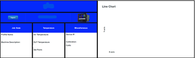

Hi everyone, I am currently trying to export data to CSV in which I have collected in my LineChart from my mashup. I have seen the following article: Solved: Re: How to Export a Custom Excel file from Thingwo... - PTC Community.
In which shows how to import CSV files but I am trying to export that data out and if its possible can is there a way to export in 30 minute intervals?
I would be exporting data from a thing in thingworx from a thing group that updates that chart if that information is helpful.
I'm using ThingWorx 9.3.5
