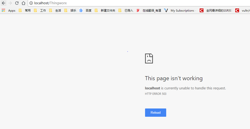

hello

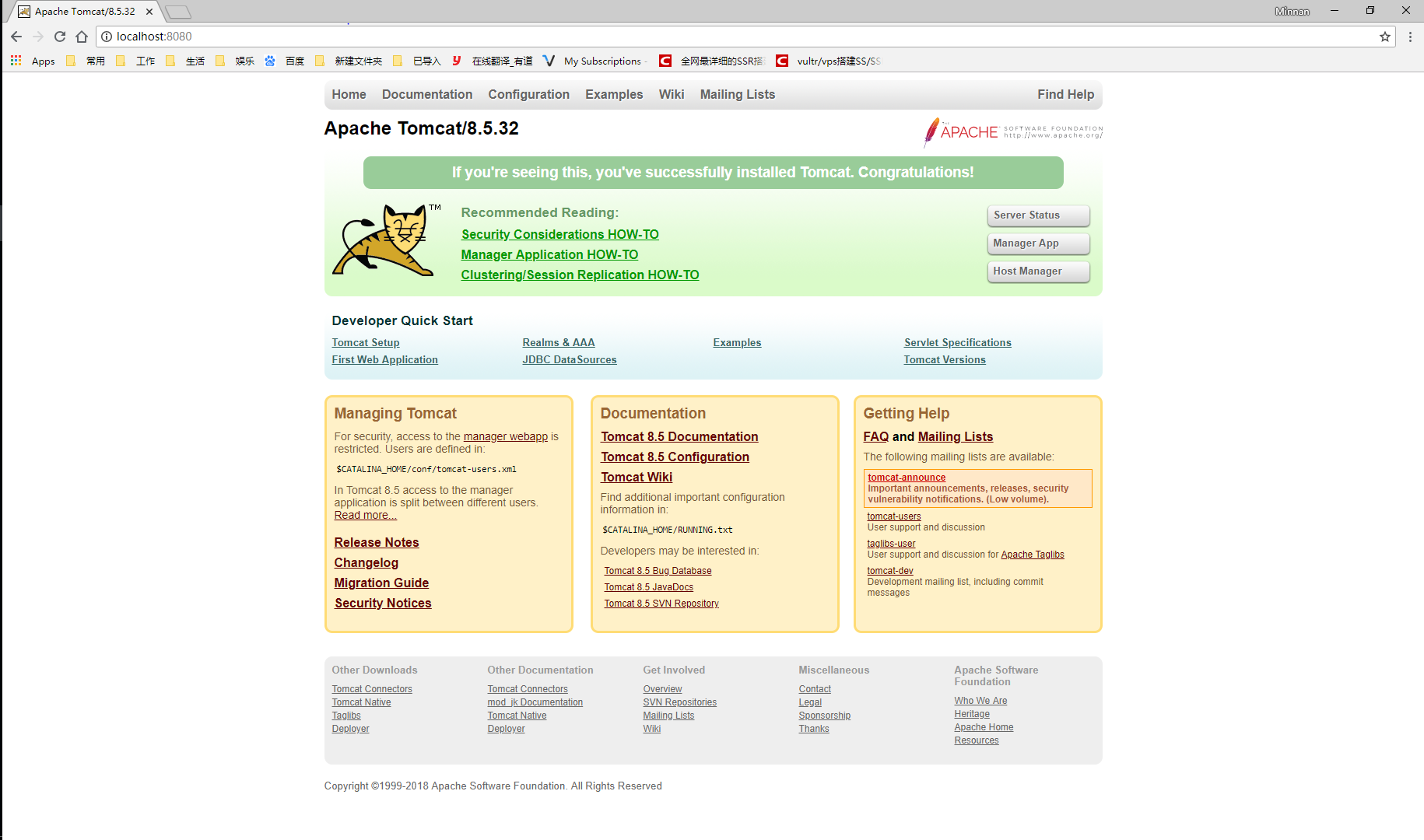

days before, i reinstall my system,from win7 to win10, both of which is 64-bit.and i am able to enter the ThingworxFoundation on win7.

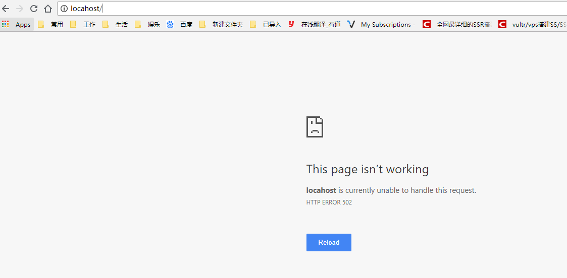

after i settle all the settings, i found i can't enter ThingworxFoundation.after i reinstall the Tomcat serval times, i verify that i install Tomcat8 successfully by enter localhost:8080.
but when i put the Fadation files into their palce, and re-start Tomcat, i can't even enter Tomcat, neither at the port 8080 nor port 80.
here are some logs files in Tomcat before setting the Thingworx and after it.
Please help

It seems Djava.library.path is not set:
ERROR] [O: c.t.s.s.l.LicensingSubsystem] [I: ] [U: SuperUser] [S: ] [T: localhost-startStop-1] ====================================================================
2018-07-23 15:06:42.968+0800 [L: ERROR] [O: c.t.s.s.l.LicensingSubsystem] [I: ] [U: SuperUser] [S: ] [T: localhost-startStop-1] Failed to load FlxCore library. Ensure it's in PATH (Windows) or LD_LIBRARY_PATH(other platforms) or set with the VM arg, -Djava.library.path. Error message : com.flexnet.licensing.DllEntryPoint.entry([B)I
2018-07-23 15:06:42.968+0800 [L: ERROR] [O: c.t.s.s.l.LicensingSubsystem] [I: ] [U: SuperUser] [S: ] [T: localhost-startStop-1] ====================================================================
2018-07-23 15:06:42.968+0800 [L: WARN] [O: c.t.s.ThingWorxServer] [I: ] [U: SuperUser] [S: ] [T: localhost-startStop-1] Shutting down the Platform.
Please follow solution from the following article:
ThingWorx fails to start with error "Failed to load FlxCore library"
Thank you,
Raluca
