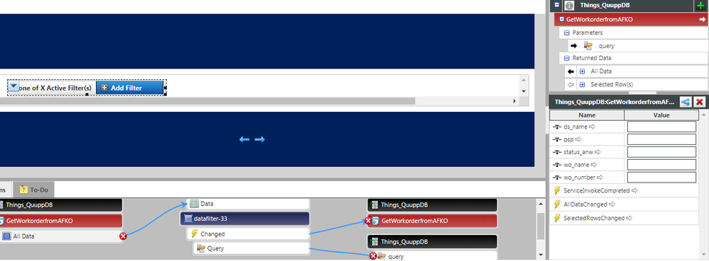

i want to use the filter widget within a mashup, to filter a GRID coming from JDBC MySQL connection?
Does this should work?

The Widget produces a JSON which you then would have to convert into a proper SQL Filter
You can then use << >> (String vs. Parameter substitution) in an SQL query.
Do be aware that using << >> is considered String substitution and is vulnerable to sql injection.
Proper validation and permissions should be used.
