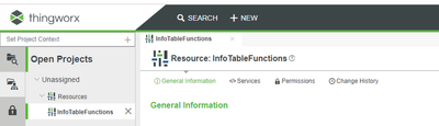

I Want to set group name programmatically through service of Resources->InfotableFunctions-> Services->TOJSON
I need standard service code to do programmatically.
Please check the below screen shot
I have implemented code similar to this, but getting error of push related as shown in below image.
from where data is getting in permissions highlighted below in bold
currentPermissions.permissions.push(newPermissions)
Pls send me root cause o this issue
This is my below developed. Pls check any issue in this

You're getting that error because you're parsing your JSON to a string with JSON.stringify().. Instead use JSON.parse().. You shouldn't have to use the parse function because that service returns a JSON but occasionally ThingWorx throws an error with JSON properties and service inputs so I always use the JSON.parse() function.   Also, I see you marked your last reply as the solution to the issue.  You may want to undo that as you haven't resolved your issue yet.
