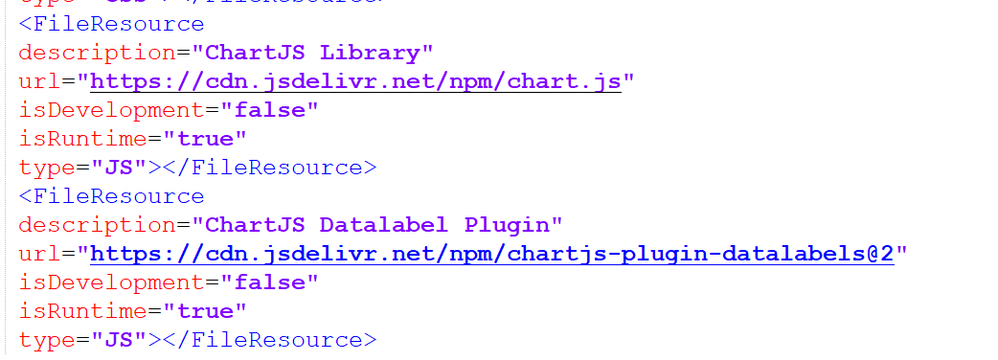

You can mention external javascript reference in the metadata.xml file

Hi Velkumar,
I can see that your answer do not mention local javascript files, how should their url look?
// Oskar
Hi @oskarberntorp
You can mention custom js like this.
Place your files under folder ui > WIDGET NAME >
/VR
And to add to what @Velkumar stated, which is exactly what you need, you don't need to add in your runtime.js any import statement like the one you mentioned.
